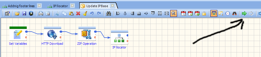

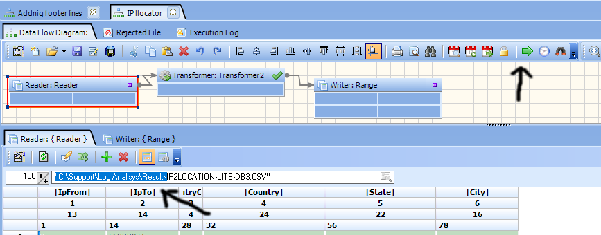

Here are some screenshots for you
Note that the directory path is different.
When a transformation is run C:\Support\Log Analisys\Result\ path is used and not C:\temp
As a developer, I want to be able to point to any folder/file and see the content of it
However, when the transformation is run from the package connection path is used C:\temp\
