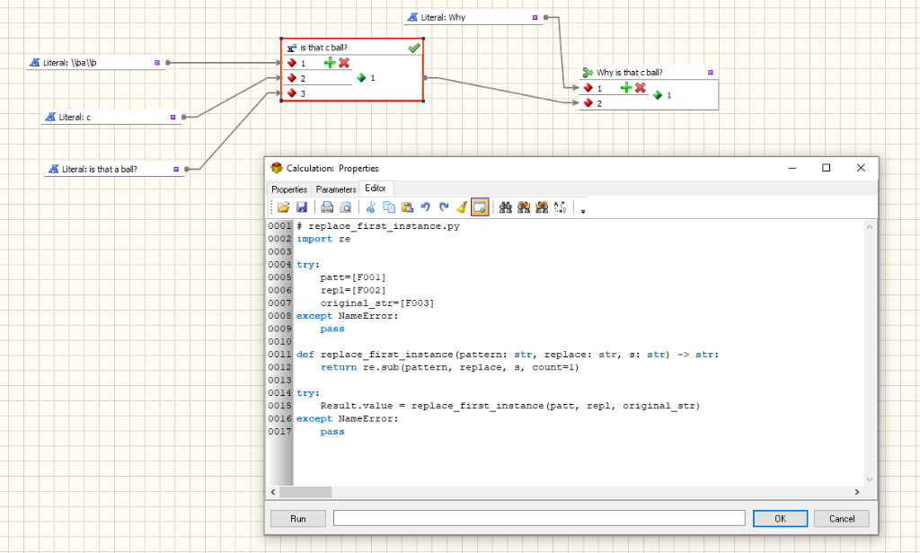

4. Paste your function into Advanced ETL's python editor and test it on ETL input
Paste your function code file in its entirety into the Calculation transform editor (or wherever you're using it). Be sure to select Python as the Language Used. Run your transform and review the output.
(Note that I had to double-escape the "\b" character in the Input sent to the Calulation transform in Advanced ETL but I did not in my test script. (the '\b' character matches word boundaries). This is because I used raw input in my test harness, but in Advanced ETL input is substituted by wrapping the input in single quotes without the raw string notation. See the python documentation for regular expressions (linked above) for more info about raw strings)
