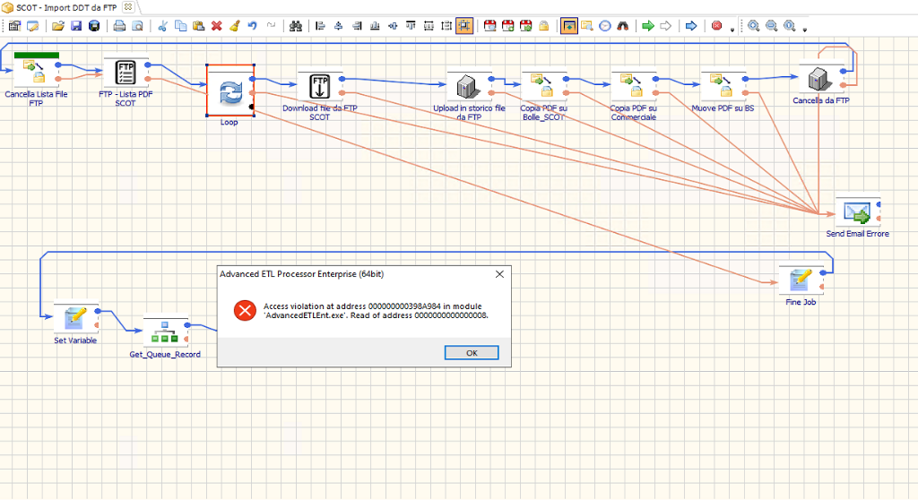

11 months 1 week ago #25769 by Concina
I updated to 6.4.6.17 and now the jobs scheduled for download via FTP fail, while they work in debug.
If I open the package and modify an element, the attached error appears.
The computer is a virtual machine with Windows Server 2022 Standard
The following user(s) said Thank You: Peter.Jonson, prashant
11 months 1 week ago #25771 by Peter.Jonson
Please post a more detailed screenshot
EG I click on this object (Screenshot) , This button (Screenshot) and than I get the error.

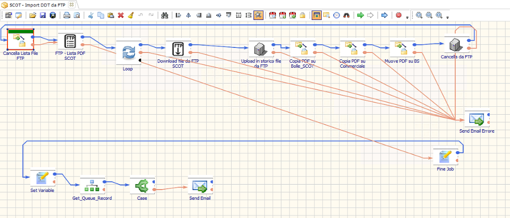

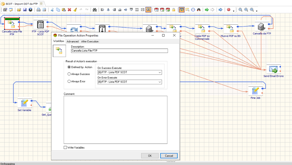

11 months 1 week ago #25772 by Concina
Replied by Concina on topic Update 6.4.6.17 problem
I open the package (screenshot 121728), open the first element (121847) and press OK (122001)
same for loop, etc. (122215)
11 months 1 week ago #25773 by Peter.Jonson
Thank you
AV Issue was already fixed this morning please try latest version
30/09/2025 6.4.6.18
 - Fixed: Package Designer AV

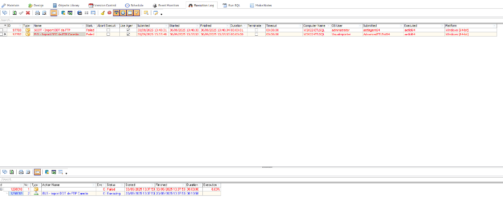

11 months 1 week ago #25774 by Concina
Thanks, With the fix, the error disappeared, but the package works in debug and not as an agent.
The only error is :
Execution of : ELS - Import DDT da FTP Caredio failed Computer Name: W2K22-ETLSQL User Name: administrator App Version: 6.4.6.18 Os Version: Windows Server 2016 Build: 20348
11 months 1 week ago #25775 by Peter.Jonson
Please double click on the second line.
It should provide more detailed log.
Post it here
