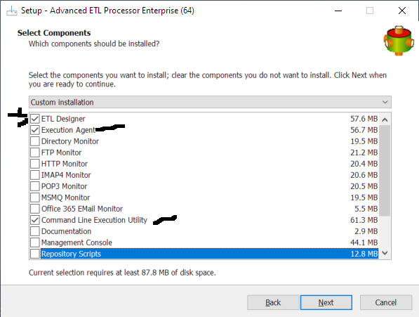

2 years 3 months ago #23635 by Peter.Jonson
Regarding Case 1
1 Install the software on the on single computer (Only necessary components)
2 Configure repository connection
3 Configure log path so it points to the shared folder
4 Close AETL
5 Copy configuration from C:\ProgramData\ETL-Tools.com to rest of the computers
6 Install the software on the on the rest of computers (Again only necessary components)
You would need to enable agent and create schedule for specific computes
See the pictures below

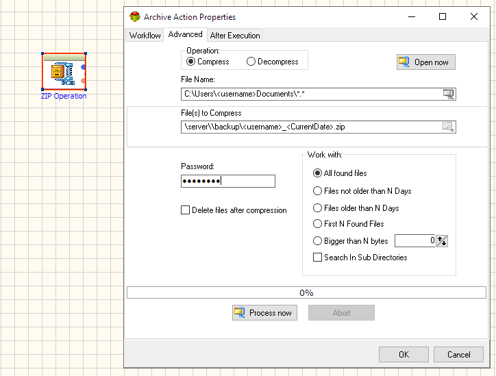

2 years 3 months ago #23636 by Peter.Jonson
Re case 2
You can create a single package which will work on all computers. use <username> as part for the path
>> Can these steps be preseted in a configuration file? Then, deploy to the user PCs based on this configuration file.
The package is your configuration so there is nothing to deploy
