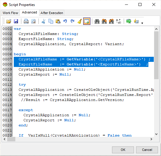

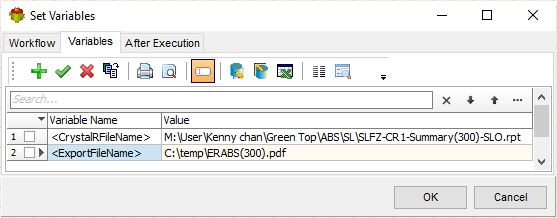

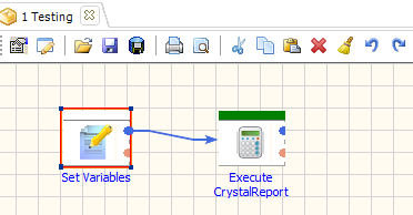

2 years 8 months ago - 2 years 8 months ago #23179 by admin
Hi Kenny
In think in your case must simplier option is to use variables.
See the pictures attached.
You can even store the variables the database and loop over it
Here is updated script for your convinience
var
  CrystalRFileName: String;
  ExportFileName: String;
  CrystalRApplication, CrystalReport: Variant;
begin
  CrystalRFileName := GetVariable('<CrystalRFileName>') ;
  ExportFileName   := GetVariable('<ExportFileName>')  ;
  CrystalRApplication := Null;
  CrystalReport := Null;
  try
  CrystalRApplication := CreateOleObject('CrystalRunTime.Application');
  CrystalReport := CreateOleObject('CrystalRunTime.Report');
   //Result := CrystalRApplication.GetVersion;
  except
  end;
  If  VarIsNull(CrystalRApplication) = False then
    begin
    try
    try
    CrystalReport := CrystalRApplication.OpenReport(CrystalRFileName);
    CrystalReport.ExportOptions.FormatType := 31;
    CrystalReport.ExportOptions.DiskFileName := ExportFileName;
    CrystalReport.ExportOptions.DestinationType := 1;
    CrystalReport.ExportOptions.PDFExportAllPages := True;
    CrystalReport.Export(False);
     Result := CrystalReport.ApplicationName;
    except
    end;
    finally
       //Result := CrystalRApplication.CanClose;
       Result := true;
     end;
  end;
end;
Very impressive script BTW
