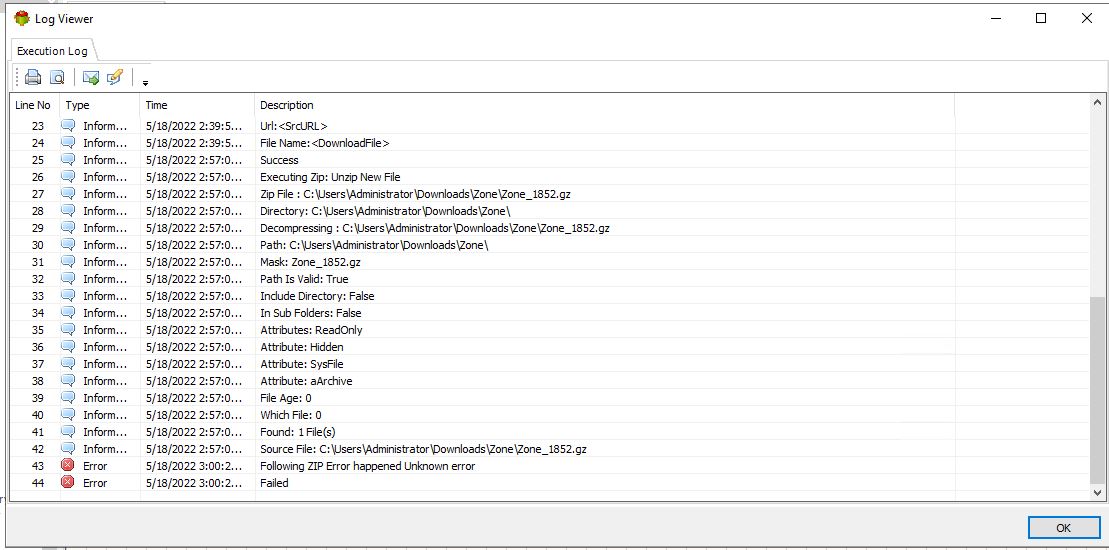

Unable to unzip large files:
Latest version, please
17/05/2022 - 6.3.10.2

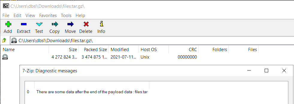

We have reproduced the problem, funny enough 3.5 gig file fails but the 7 gig file works
4 years 5 months ago #21832 by Peter.Jonson
FYI: We use 7zip libraries for working with archives.
I have installed the latest version of 7zip and tried to decompress the same file and it failed as well.
(Band zip worked fine)

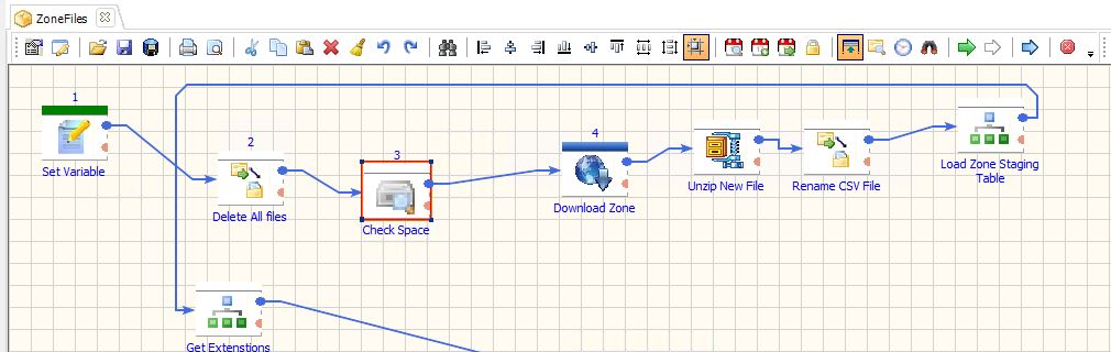

I think you are correct. I am doing some more testing with even a larger file. I think the root cause was my disk space was too limited. I freed up some space. I also put a check in place to stop the ETL if there's not enough.
