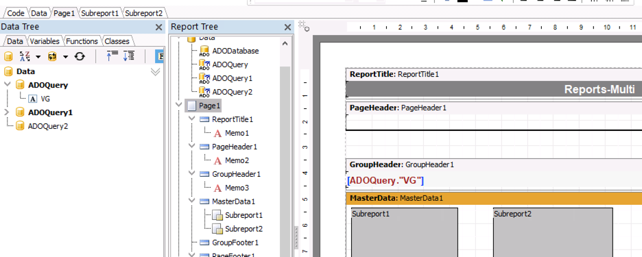

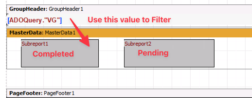

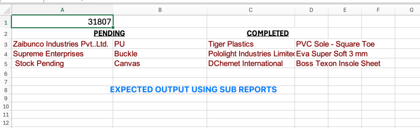

I have a simple report which showcases Pending Items and completed items in a BOM. See details below from a regular report
What I want to do instead is keep the output side by side , which should be possible via sub reports , as of now , I get "ALL" items
Based on the link here  www.fast-report.com/blogs/subreport-from-parent-report
It seems , I need to write a code so parameter can be passed from primary report into subreport but all my effort fail OR set relationship by loading the data twice , I did that too but no avail

2 years 2 days ago #24603 by admin
I reviewed the video you created and noticed that you are using only an ADOQuery object.In your situation, it would be beneficial to implement a master-detail relationship. This means you should have one ADOQuery object for the main report and another for the subreport.
2 years 2 days ago - 2 years 2 days ago #24604 by prashant
I am trying it but how do I set the master - child relationship ? I mean which menu , button?
Update
1. I did try to set in object inspector, is this what you mean?
2. There is also a bug , if you rename the next query ADOQUERY1 to something else, it's not updated in the object inspector of ADOQUERY , see my screenshot
3. After setting Master, what's the next step? how do I define the relationship , and define the filter

Lord the amount of time on this weekend I invested trying to figure this ,THANK you so much this.
This is a quick and dirty trial (it's 7AM here) . I required 3 queries , one for each type of status ' Pending' , Completed' and it's master
