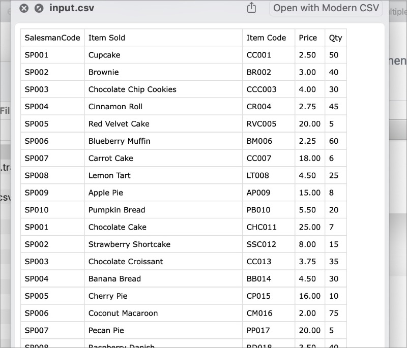

Purpose : - Generate a filtered file for each salesman which is emailed to him/her.
Brainstorming
1. I am thinking using new loop action in package, I should be able to pass variable into a transformation where I could technically pass this onto a validation but how do I even run this transformation ?
 2. How to generate customised file name based on column name?

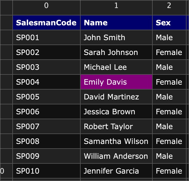

Input 1 - List of Salesman with UniqueSales Code
Input 2 - List of all sales done by them

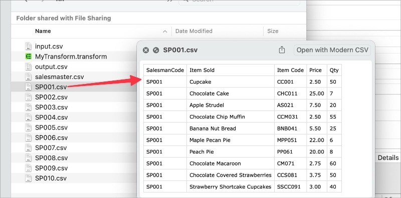

Output 1 - Expected - Filtered CSV containing relevant data for sales person
All the CSVs are attached in the files (seriously allow us to upload csv)

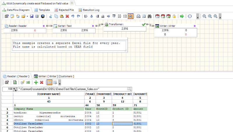

Let assume that you have a sales file with 10 million rows and 10,000 customers lookup file
Loop reads list of customers file and passes customer id to the transformation
Transformation reads 10 million rows from sales file and filters it by customer id and creates the file
So the entire loop will read 10 million rows 10,000 times
That will take a lot of time and processing power
The better and faster option is to use a single transformation
The default repository has an example 0016 (every example has a number)
It does exactly what you want

2 years 3 months ago #23579 by Peter.Jonson
>>>I will absolutely prefer automation and tonnes of processing power to do this than load this 1 by 1 with 0016.
It is is probably all my fault because I am not explaining it correctly.
0016 is the fastest option, It does everything in one go, without loop  and not one by one

  • Can you explain the mechanics of this calculations below
begin   if GetVariable('<file_name>')<>[F001] then //  record chaged   begin     SetVariable('<file_name>',[F001]);     SourceChanged; // creating new file   end;   Result:='test'; end;
  • Can I also assume this will work for CSV to CSV output as well? This is csv to xls
