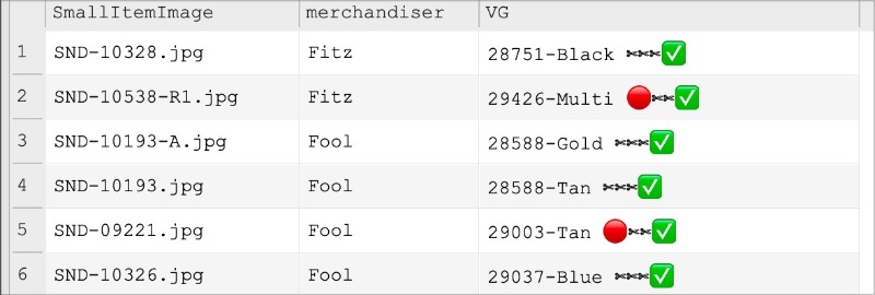

I am trying to split column into rows using delimiters in an excel file ,
1. every time I try to split new column the previous column get auto sorted . Please see LOOM attached  . I have attached my bulk transformation and excel file
2. is there a way to put a loop to do this for all columns or it has to be done 1 by 1
Cheers,

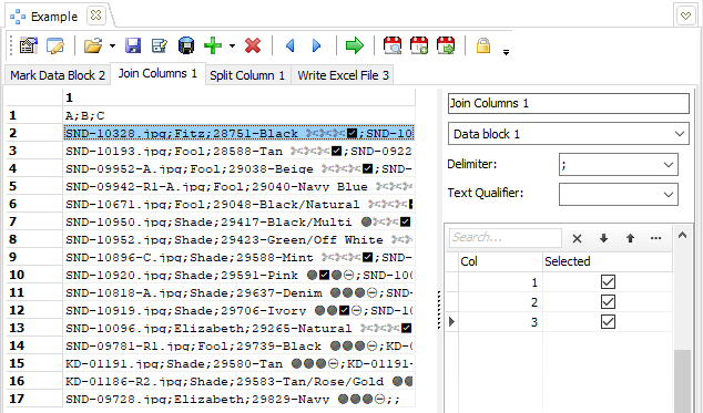

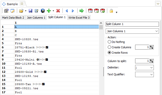

I think joining the columns first and than splitting them is a better option. (No need for loop)
Please note that there a small issue with data block transformation right now so you may need to to reopen it to see the changes.

Your suggestion is right , if I join the columns first and then split it would be much easier, but I can't figure how to divide them the long 1 singular column into multiple column output

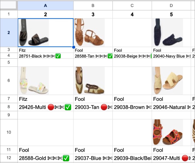

Background
I am currently experimenting with ETL capability of data manipulation (on my already existing projects which we run with python and EDT).I am trying to re-create a picture format like structure in Google Sheet/Excel . It leverages Image formula , For reference this is the end results
The starting point is data as below. Data is attached below
File Attachment:
File Name: output1.xls
File Size:31 KB
Output should be format data in a grid of modular X columns x Y rows , in this example let's say we are looking at 3 columns X unlimited rows .
The end output expected from ETL is planned as below,

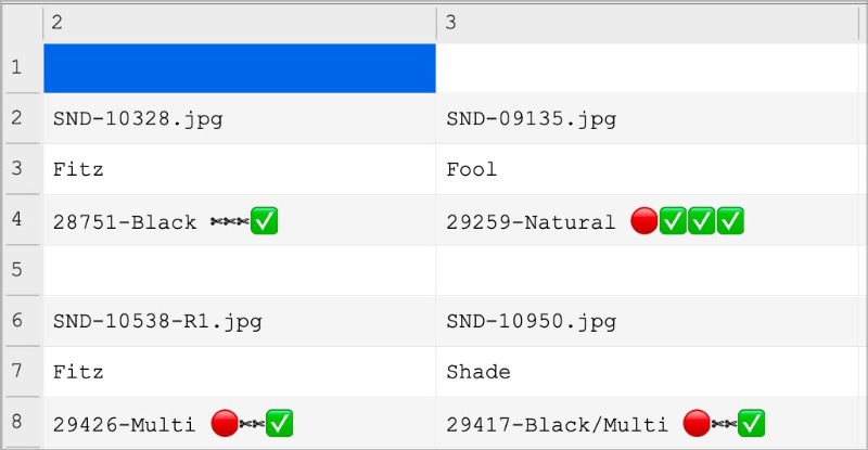

The main challenge here is to convert a single column into 3 columns .
The can be done using pivot block transformation
Please see attached example.
